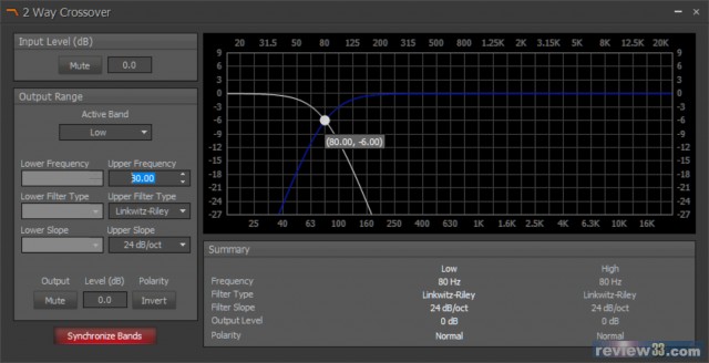

I know you are more about measurements - #30 [manyung1987], 24-07-15 01:08Also, I found using tone signal at crossover frequency for calibration is also referenceing and easy to begin with.
For using a Linkwitz-Riley 24 dB/oct, the level of each signal has -6dB drop.
That means after mixing High Pass Signal and Low Pass signal will result a balanced signal level 0db (+6db)

最後修改時間: 2024-07-14 18:36:04 - #25 [manyung1987], 24-07-14 18:26想討論下如果 Stereo 系統加入 .1/.2 Subwwofer, 大家又會點 Cal
首先 Crossover, 先定好一個 Reference 點, For example, 80Hz
如果 Main Speaker 播 -20 dbfs pink noise signal, 較到 85 dB SPL C Slow
Subwoofer 要調到幾多 db SPL C Slow ?
之後到 phase, 要用什麼方法較正 ? - #24 [hahayanyan], 24-07-13 23:05Long long hing
