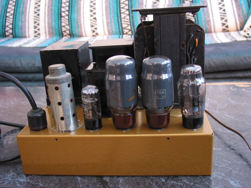

- #14125 [NEC], 07-02-13 12:38this single one ended at USD2,125 and will go to Taiwan.
- #14124 [Ace_Hayashi], 07-02-13 12:11The highest I have seen so far and it does not come with GEC KT88! Leak fever is spreading :-)
- #14123 [Gingers], 07-02-13 12:00Ended at 2500 US
- #14122 [dd845], 07-02-13 10:35Very nice cosmetic condition..
- #14121 [dd845], 07-02-13 10:34
- #14120 [dd845], 07-02-13 10:33Ended at US$2,500.99

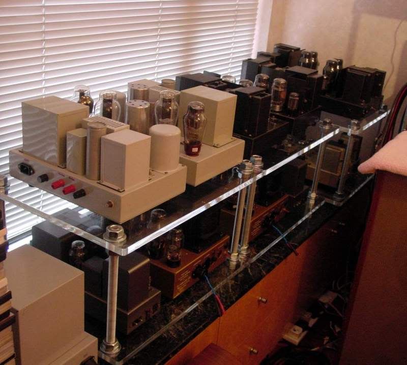

哈哈..! 裝修工人放左工, 又可以o羅 老毒物 出廳..
"每日一進步" - 去左鴨記, 今日有大躍進! 歡迎 "洩"掌門 抬機來!!!

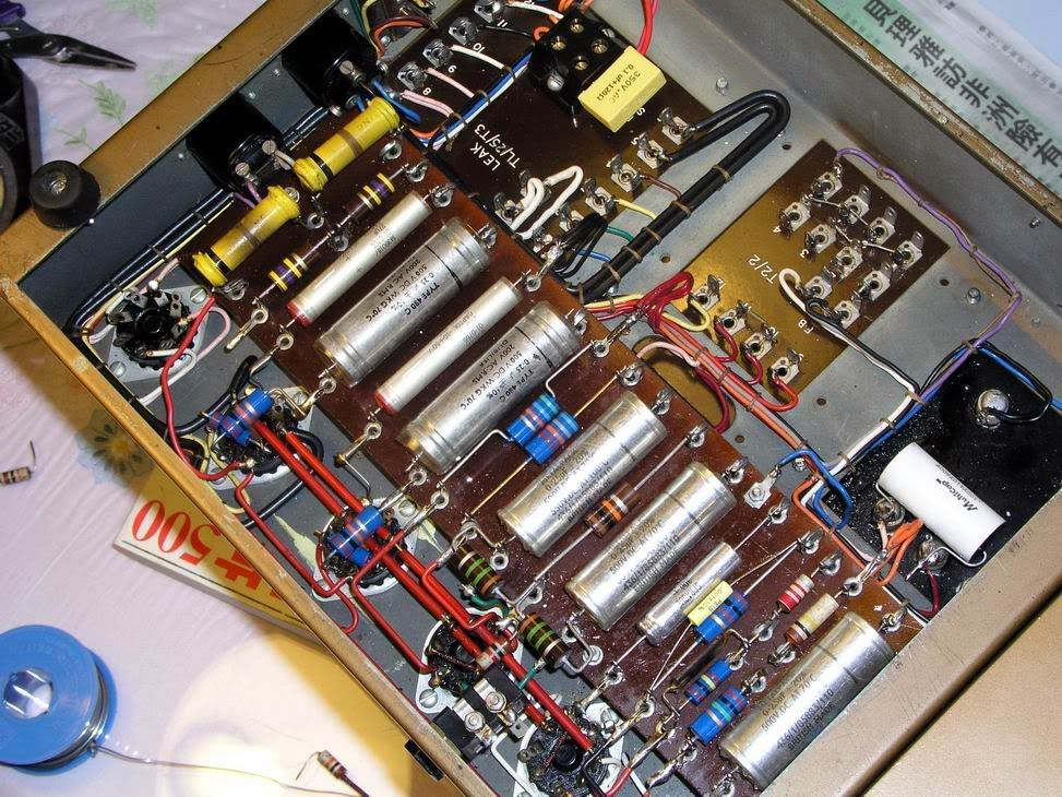

Posted by ________ in _______ - #14111 [Gingers], 07-02-13 08:51今早凌晨關機時發覺其中一隻"老毒物"體溫偏高,馬上反轉一看,不得了!其中一粒25uF 50V陰極傍路電容像火山爆發咁噴緊岩漿!!
阿Tim講得o岩,12.1 not suitable for newbie...三思!! - #14110 [Gingers], 07-02-13 08:49Good morning..

今日發現其中一部12.1體溫有點不正常,咁就徹底check check呇P度度,一度原來所有TCC都Leak既..買果陣仲話有一部d caps得既,昆人既!! >______<
Almost of all TCC都打柴!!
"好彩發現得早.."
Yes!體溫不正常那部coupling caps漏直流達30V!!!另一部亦達17V!!記得X師傅話超過1V就要小心...>___<
John, beware..
搞好後播聽至3:00am..意猶未盡....以後可以多點時間專心聽musics la..
Even Leaky capacitors can poison :-) - #14109 [Gingers], 07-02-13 08:47Old post by DD on 04-03-14 22:36
